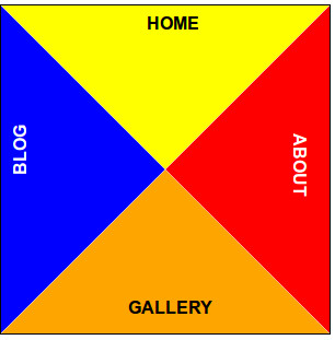

    Hier noch was Sinnfreies
    <!Doctype Html>
    <meta charset="utf-8">
    <title>Sinnfreie CSS3 Spielerei</title>
    <style>
    nav {
     margin:0;
     padding:0;
     width:300px;
     height:300px;
     border:1px solid #000;
     float:left;
     position:relative;
     overflow:hidden;
    ul {
     margin:0;
     padding:0;
     list-style:none;
     width:500px;
     height: 500px;
     background-color:#2EFEF7;
     transform:rotate(45deg);
     position:absolute;
     left:-100px;
     top:-100px;
    li {
     list-style:none;
     width:250px;
     height:250px;
     float:left;
    a {
     width:250px;
     height:250px;
     display:block;
     text-align:center;
     color:#ada;
    a:hover {
     background:rgba(200,200,200,.5);
    li:nth-child(1) b {
     float:left;
    transform-origin:25%;
     transform:rotate(-45deg);
     position:relative;
     left:140px;
     top:150px;
     color:#000;
    li:nth-child(2) b {
     float:left;
     position:relative;
     left:60px;
     top:140px;
     color:#fff;
    li:nth-child(4) b {
     float:left;
     position:relative;
     left:60px;
     top:90px;
     color:#000;
    li:nth-child(3) b {
     float:left;
     transform:rotate(-135deg);
     position:relative;
     left:140px;
     top:80px;
     color:#fff;
    li:nth-child(1) {
     background:yellow;
    li:nth-child(2) {
     background:red;
    li:nth-child(3) {
     background:blue;
    li:nth-child(4) {
     background:orange;
    <nav>
      <ul>
        <li><a href="#"><b>HOME</b></a></li>
        <li><a href="#"><b>ABOUT</b></a></li>
        <li><a href="#"><b>BLOG</b></a></li>
        <li><a href="#"><b>GALLERY</b></a></li>
        </ul>
    </nav>
